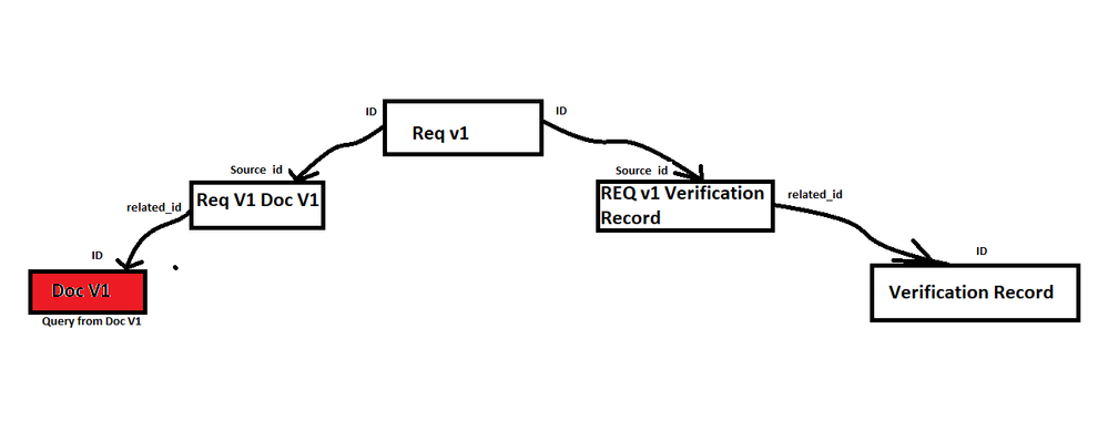

Im Trying to do a whereuse on Doc V1 table to get data from a relationship called Req V1 Doc v1 which is linked to another item called Req V1 and then Req V1 is linked to another item via relationship to Verification Record is my script below looks good for report query?

  • If I understood your data structure from this query correctly the first "select='source_id'" and "<source_id> should be replaced with "related_id" as in the inner "Relationships" tag.

      Thank for the reply the following is the data structure and i want to run the query from doc v1 as can be seen below. the relationship is from req v1

        Try this:
        [embed:dc8ab71f-3b98-42d9-b0f6-e21e02a0f8e2:50f84b01-eca7-43fe-a6f3-b5c2ca43474a:type=xml&text=%3CItem%20type%3D%27Req%20V1%27%20action%3D%27get%27%20select%3D%27id%27%3E%0D%0A%20%20%3CRelationships%3E%0D%0A%20%20%20%20%3CItem%20action%3D%27get%27%20type%3D%27Req%20V1%20Doc%20v1%27%20select%3D%27related_id%28id%29%27%3E%0D%0A%20%20%20%20%20%20%3Crelated_id%3E%7B%40id%7D%3C%2Frelated_id%3E%0D%0A%20%20%20%20%3C%2FItem%3E%0D%0A%20%20%20%20%3CItem%20action%3D%27get%27%20type%3D%27Req%20V1%20Verification%20Record%27%20select%3D%27related_id%28id%2Cstate%29%27%3E%3C%2FItem%3E%0D%0A%20%20%3C%2FRelationships%3E%0D%0A%3C%2FItem%3E]
