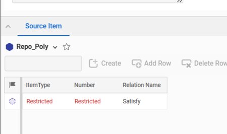

We did not add any server events on any types, the OOTB events already exist on our Poly type.
Is there anything else we need to do?

Regarding the "Restricted" entries, from my experience the most common causes are:
- The current user does not have permission to discover or get the referenced item.
- The related item cannot be resolved correctly, even though the relationship record exists (for example, an incorrect related_id).
Since you mentioned that the database entries are identical and that assigning World permissions did not help, I would investigate whether an additional metadata refresh, cache refresh, or server restart is required after adding the Poly Source relationship programmatically.
If you manually add the same ItemType as a Poly Source, save it, and then compare the resulting records (including any related metadata tables) with the programmatically created version, do you see any differences at all?

This is what we think as well, we compare the DB before and after adding a type manually and through our method, and only difference we saw was the Type not being added to the "List", everything else was identical
Any idea if this can be done programmatically :)
Only 2 tables were altered (in terms of row count), the Morphae (adding relation for new Type) and the Values (List values)
Since adding a Morphae relation doesn't add item to list, that part was missing from our programmatic approach.We have tried adding the type to the list as well but we still see the same Restricted
