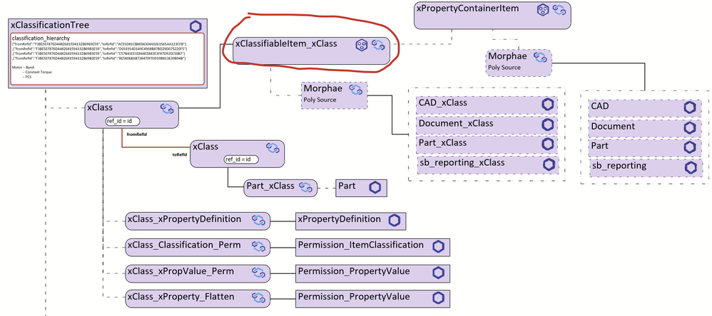

One thing that has not been mentioned is a detail that Angela P. point out some years ago and is critical to a PolyItem. It's data is retieved via a View. So, as you add Itemtypes to a PolyItem a View is also updated.
For example, Here is the data model for xClass: Lets focus on xClassificableItem_xClass

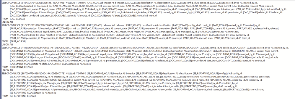

Here is the SQL Server View for xClassificableItem_xClass:

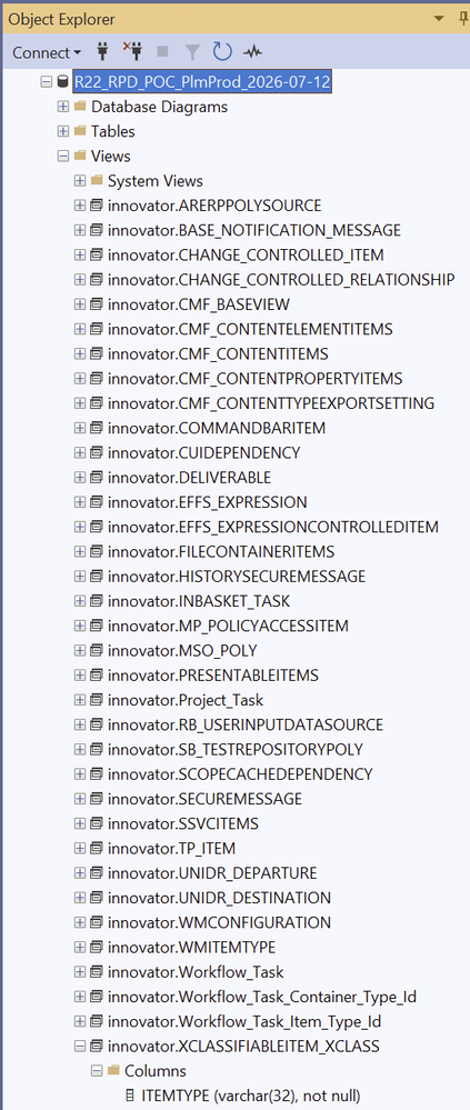

So, be sure that the View is being updated.
You can Check by going to Views in SSMS ..... xClassificableItem_xClass ...... DesignGood Luck
