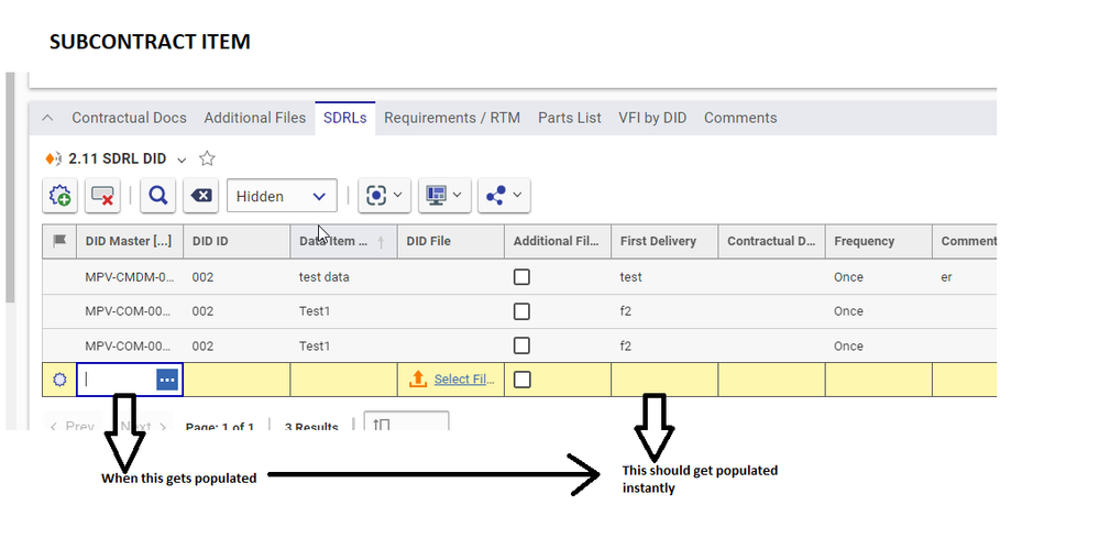

okay so ill rephrase the issue again:
There are two items Master DID and SDRL
Both these item contains a property called first_delivery which is a string data type.
Supplier DID has a property called master_did which is an item property links to Master DID item.
There is a third item called subcontract, when the user creates a new SDRL from the relationship in subcontract item and select master_did I want first_delivery to be populated instantly from Master DID before saving.
Please not: it cannot be foreign property as it should be editable
Following are the screen shots.
