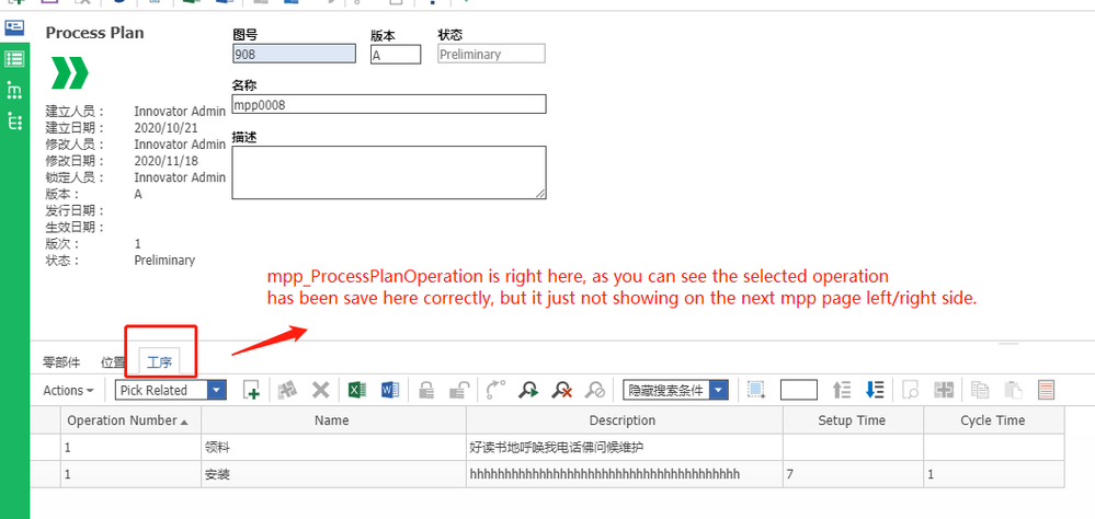

Hi Angel, I totally agree with you guys and there should be something connect the existing Operation to ProcessPlan, I check into the DB mpp_ProcessPlanOperation Table and here is what I found, property source_id is ProcessPlan property id which is used to connect the Operation to individual ProcessPlan, and also property related_id represent for mpp_Operation property ID , which stands for mpp_ProcessPlanOperation is the relationship type of mpp_Operation. So, I am confused that anything else should be set here? Thanks!

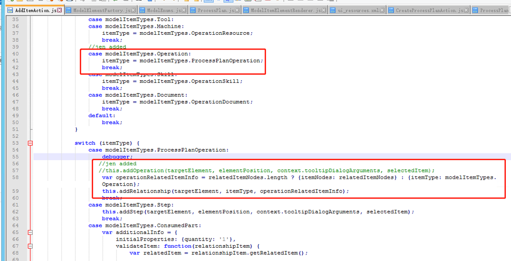

Hi Angel, I did compare the case for Skill with the Operation, and change the code like this, which is use for adding an existing operation instead of OOTB manually inserting an operation. I think ConsumedPart is the same thing, right, puzzled... Thanks.
