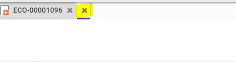

    However the tab that opens up has no tile set it (Refer Screen shot)
    Anyone aware on how I can set the Title of the tab while using aras.uiOpenEmptyWindowEx(node)?
