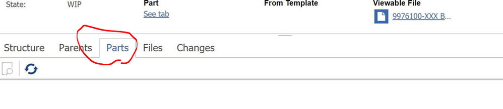

The actual issue was in PLM some of the parts were not displayed as shown below,
Those parts were created using the cad connector. To troubleshoot this issue i thought to put a break point code in the method PE_GetRelatedParts.
That resulted in error. My actual requirement is to check the root cause of parts not displayed in one of the CAD item in plm. This is happening only for one user account. I tried with admin/. supper account and my account as well. It is working perfectly as expected. I can able to view the parts for that CAD item. So i couldn't find a way to approach this issue to resolve.
How do i approach this issue?
