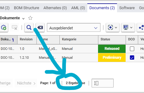

page, pagesize and itemmax were the perfect trigger words!!!
Last year I spent a lot of time to integrate paging into my federated ItemTypes. I learned a lot about how Innovator assembles the data in the main grid, form and relationship grids and the paging system itself.
There is already somebody who does the counting and is only triggered once! The countOnly return mode!
I'm not sure what to do with this idea yet. But whatever updates the page counter, can maybe also update my indicators. (if it will work in combination with a batch loader is another question, lol...)
