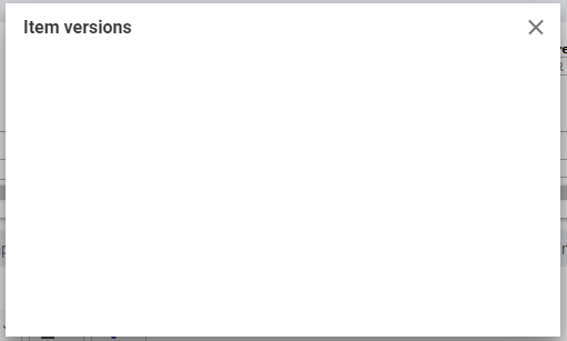

Hello Team,
If we are opening any Item from  Relationship & trying to open item version ion that case version window is showing Blank window.
but if we are opening same Item from main TOC then it is showing.

    It is throwing error in below code:
    const lockColumnInfo = columnObjects.find(findColumnByPropertyName.bind(null, 'L'));
    lockColumnOrder = lockColumnInfo.order;
    Here we are getting lockColumnInfo is undefined.
    But if it is open from main TOC grid then it has value.
