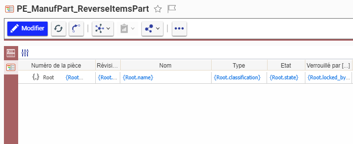

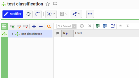

hello
i want to know if someone as any information on those interfaces, i can't  name them and i've never came a cross a topic talking about them so any information would really help
thanks

  • Left one is a tree grid view (TGV). It works together with a QueryDefinition. The particular one shown should be used for Manufacturer Parts in the related Part relationship tab. If you come from Innovator 11 -> this is something new in Innovator 12 and replace the previous way related Parts where shown.
    Right one is an xProperty/xClass definition. xProperties are for example use to build classification trees. Google xProperties or xClassifcation.
    This japanese video contains a nice demo: https://share.vidyard.com/watch/LNx6DGDNJxa8RzGMb1G1Ef?chapter=1
    • lucas's avatar
      lucas
      thanks for your response but i think i didn't explain my self well, actually what i wanted to know is what is the interface that those two example shares with the big colored left bar, and where is it defined that these interfaces are different from the classical form and relationship tabs interface.
