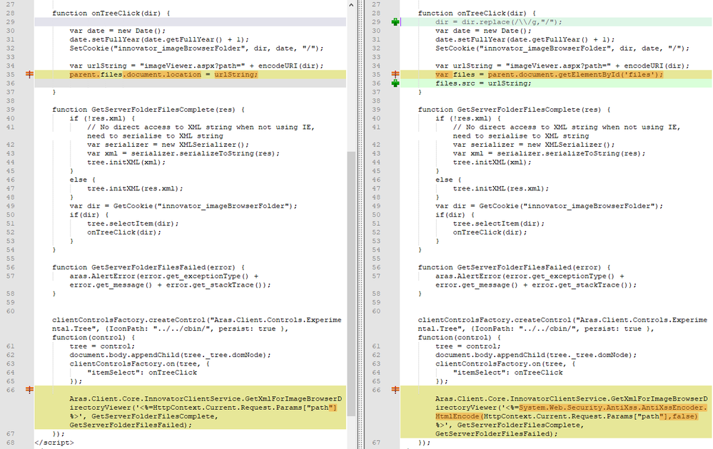

    this one is a known and common issue in Innovator 11. It should be a bug in codetree file ..\Client\scripts\ImageBrowser\imageTreeViewer.aspx
    Your file should equal the left file shown in this image. Right side shows patched version:

      Angelalp,
      Thank you for the suggestion, but my file has the updates made to it.  Any other ideas?
