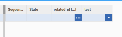

I added a foreign property "test" in Manufacturer Part to link a property from Manufacturer to Manufacturer Part.
Then I added a foreign property in Part AML to link the "test" property from Manufacturer Part into "Part AML". This one worked for me!

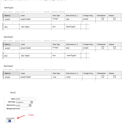

- Guido_Guizzi4 years agoIdeator II
If I use nash, I can retrieve the correct value of prop1, but in the form, it doesn't show the original List of ItemType "ItemType3" of the example

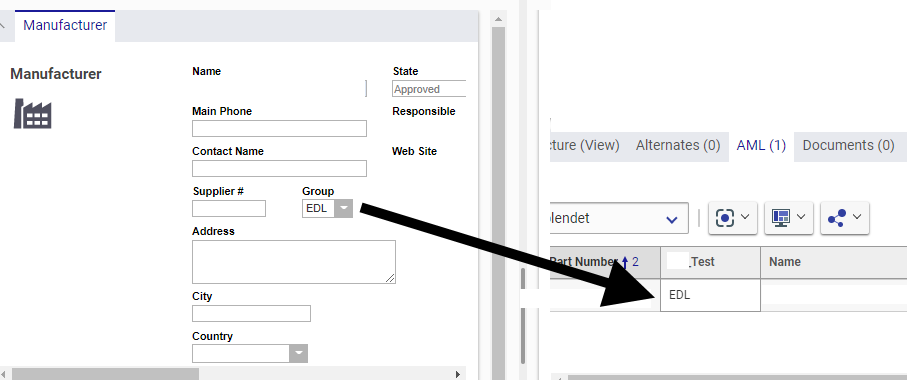

I changed it to a list property in Manufacturer and it worked too!
See here:
List property is linked from Manufacturer to Manufacturer Part to Part AML.
I don't use multilingual extension.
It is showed here
but not here
What is your version of Aras?
