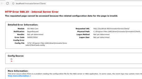

HTTP Error 500.19 - Internal Server Error
This error hits while installing the ARAS innovator, if User done install the .Net Hosting bundle.
The solution was to download and install the MS .Net 8.0 Hosting bundle from below link.
HTTP Error 500.19 after installing Innovator 2025 - Solved - Getting Started - Aras Community - Aras Community
