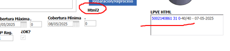

2. Yes, the alert works perfectly, I put it before or after the uiShowItem, and it shows me the ID correctly, that is, the data arrives correctly.
3. That's the "strange" thing, if I click on enter it doesn't do anything, but if through the whereuse or the menu, I open the LPVE (Lineas de Orden de Venta) and I close it, the link works correctly. And it opens.
1. I used an HTML field, which is where I have the style and the function. And a FormattedText field which is where, through an SQL, it fills in the values.
I don't know how, but by testing, a lot of testing, trial and error, I saw that the FormattedText field took from the HTML field whatever there was, styles, functions, etc.
I'm going to try your idea. :).
Basically the text, the links, would be a whereuse of those Manufacturing Orders with their corresponding LPVEs. But they prefer it there and not in a new tab, which would be easier.

What is your primary goal? Shall the textarea be editable for the users later? Or do you solely use it as a container for your Method generated content?
Does the link work when you refresh the Form manually?
Do you just need one single link? In this case a simple ItemProperty would do the job.
