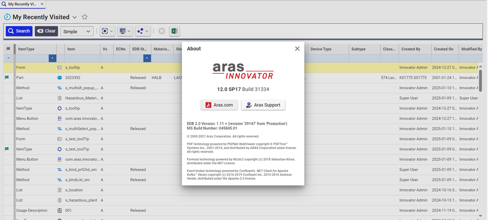

Thanks EricTD My innovator version is below
- Kirtika_Kavya11 year agoIdeator I
Thanks AngelaIp . I have implemented same method from this GitHub - ProcessPLM/Aras-Mouse-Over-Help: . It is working fine but if i delete any field from the form after that it will through error. I guess , it will impact on Performance as well.
