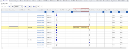

Which Innovator version do you use? In older Innovator versions (I12) the HelpText and Tooltips doesn´t work yet but you can add them manually via an onLoad Method.
- EricTD1 year agoIdeator II
Hi Angela,
We're on Release 20 and I don't think it works straight away which was unexpected.
Going from the Aras-Innovator-2024-Release-Release-Notes.pdf we need to upgrade to Release 2024 (I guess Release 33 or so).- angela1 year agoCatalyst II
Yes, I think it was around this version when tooltips were added. You can try this community project but it´s a bit dated: https://github.com/ProcessPLM/Aras-Mouse-Over-Help
Personally I just would solve it with a simply onLoad Method before starting a big upgrade project just for this specific feature.
This is all you need:
const y = getFieldByName("item_number");
y.title = "Useful info";- EricTD1 year agoIdeator II
Ooh, I would need a little bit more than that.
At this moment I have little time to experiment but do appreciate your contributions.
I quickly tried in a Release 30 sandbox that I have and both the Tooltip and Helptext work like a charm (out of the box), don't know what the first release is that it worked. It really is what we all need, I'd say.
