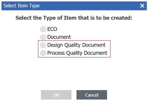

How to hide Design Quality Docuement and Process Quality Document option in selection dialog?
Hi Expert,
I tried to hide 'Design Quality Document' and 'Process Quality Document' option from the Dialog below that is populated from Corrective Action Plan.
So that, a user can see only on ECO and Document. Can we also show DCO too to add DCO?
Thank you so much for your help in advance.
Joseph
  • Hi Joseph,
    Those options are controlled by the Poly Item qs_Preventive Action. All you need to do is edit that ItemType's Poly Sources to remove the DQD and PQD ItemTypes and add the DCO ItemType.

      Hi kmarsh,
      Thank you so much for your help!!!
