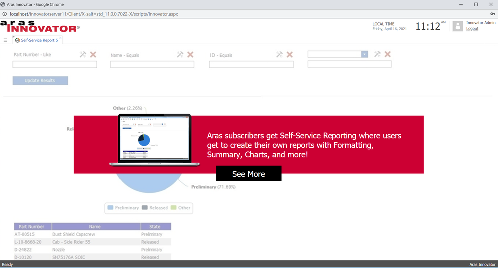

Hi ,
I have installed ARAS 11 in my local machine , I need to create a report but when I try to navigate My reports -->New Report , Im getting below page instead of creation page.
I found a solution from ARAS Guide saying that , I need to enable self service report inorder to work on it .
How to enable self service Report to work in my local Machine?
Regards,
Keerthana.
  • Hi Keerthana,
    this one is a subscription feature. It will work as soon as you have activated your license. If you don´t have license, you cannot use this feature. But you have a couple of other options like classic XSLT reports, Tree-grid-view Excels or Microsoft SSRS.
