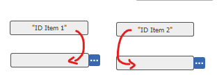

But the purpose is to automate this process, To achieve this, I need to find a method to do a "copy-paste" the value from a text field to an item field. Whose are in the same form. I attach a picture to illustrate my point. In my text field, I have a string, which correspond to the ID of the item. I see that you can write ID in it when the item is lock. and it's a link towards the related item when it's unlocked.
Can you rovide me some advices to write the good method to do this ?
I hope your can understand my need.
