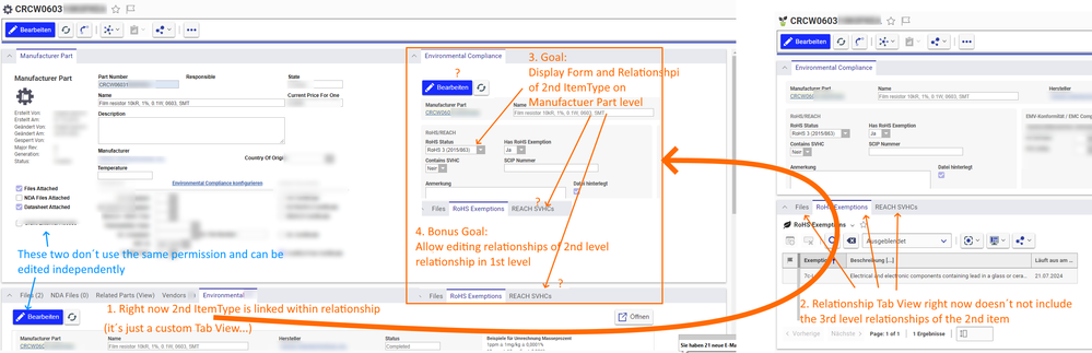

So this is a mockup of what I want to build (not final):
Right now I can achieve to display the main form of the 2nd ItemType in Manufacturer Parts (either Nested Form or custom html).
But I also want to include the additional edit/save/refresh buttons and the relationships. What options do we have?
1. It´s maybe possible to federate the additional relationships in MParts, but haven´t tested yet.
2. Does anyone has experience with customizing the accordion tabs? Can they be used for this tasks?
3. Or maybe make a  custom relationship rendering inside self designed html element?
4 ....?
Any hint is highly appreciated! Thanks!

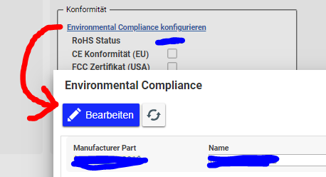

      The example in my previous image is ugly, as we have two edit buttons. For the use case above I right now load some of the data from the 2nd item on Form load. In addition I added a small link similar to a button so users can modify the 2nd itemtype quickly:
      But I still try to find a solution to merge relationship in a similar way.
