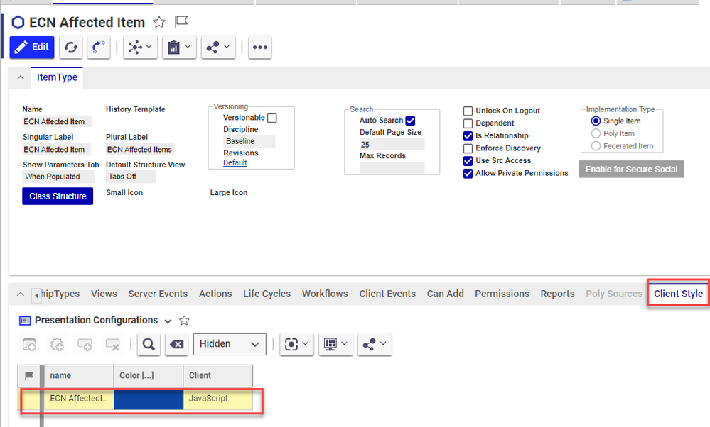

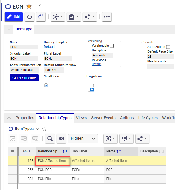

    Open the ECN Item and go to Relationships tab. For this example, I am changing the ECN Affected Item.
    Open the ECN Affected Item (Not the relationship)
    - Go to Client Style

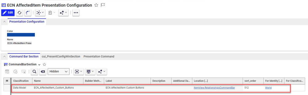

    - Create a new Presentation Configuration (If already exists, just open the existing one)
    Create a new CommandBarSection.
    Open CommandBarSection created above.

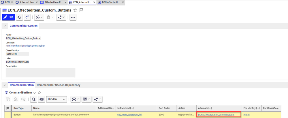

    - Add the existing Command Bar Item: itemview.relationshipscommandbar.default.deleterow
    - Enter remaining fields per screen shot, except the Alternate. (we have to create this first)

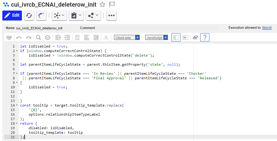

    Copy method:  cui_ivrcb_deleterow_init and create a new method. Adjust the if statement as needed based on the LifeCycle States you want the button disabled for.
    let isDisabled = true;
    if (window.computeCorrectControlState) {
    isDisabled = !window.computeCorrectControlState('delete');
    let parentItemLifeCycleState = parent.thisItem.getProperty('state', null);
    if (parentItemLifeCycleState === 'In Review' || parentItemLifeCycleState === 'Checker'
    || parentItemLifeCycleState === 'Final Approval' || parentItemLifeCycleState === 'Released')
    isDisabled = true;
    const tooltip = target.tooltip_template.replace(
    '{0}',
    options.relationshipItemTypeLabel
    return {
    disabled: isDisabled,
    tooltip_template: tooltip

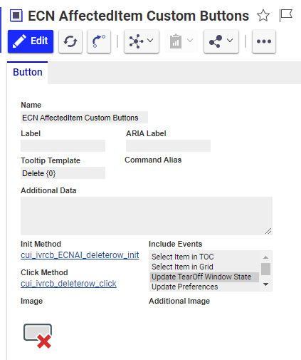

    Open the Command Bar Item above (this will open the existing Command Bar Item)
    - Click the ... -> Create New Button
    - Fill in the fields as shown.

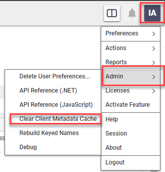

    The delete button should now be disabled when the ECN is not in New or In Work states.
    - If you are not getting the results you expect, clear your Metadata cache.
