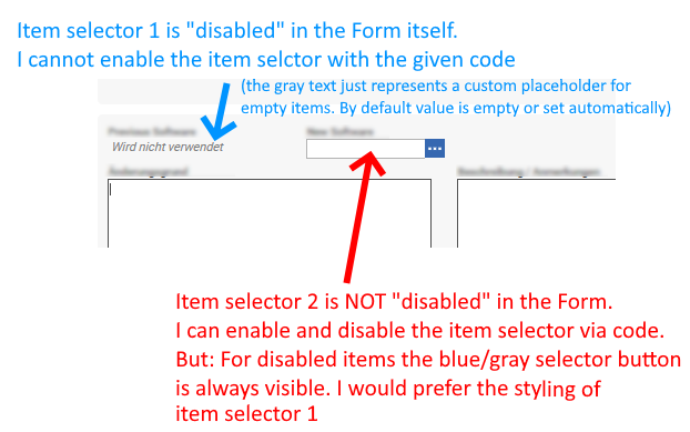

I have an item selector that is disabled by default in an I12 Form. The value for the item property is set by Method most of the time.
Now there is one special use case were I want to allow users to choose the item manually. In this case I want to enable the item selector with an onLoad event.
I right now use the code sample of following blog article for disabling/enabling the selector: https://aras.com/en/blog/disable-form-fields
The code still works fine, but only when the "item property" is NOT disabled in the Form from the start.
This image shows the situation with two item selectors. The left one is disabled in the Form, the right one enabled. For both selectors I use the code from the blog article to enable the selecotors:
Does anyone know how to enable the item selector when it was completely disabled in the Form?
I assume the current solution needs the item selector button and the item box to be visible.
I would be prefer a solution where the item selector is either enabled - OR completely hidden. I want to avoid a "greyed-out" selector cause people still would assume they can use it somehow.
