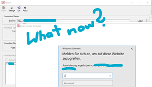

Hi Chris,
Yes I use active directory! I made short video to show the real-life situation: https://www.youtube.com/watch?v=ILRCcWhpPlY
Target version is I12. But I use the latest export/import tools cause they support language packs a lot better than the previous versions.
The F12 trick worked! Innovator ask me for database selection again as soon the cookies were deleted:
Thanks for this tip! It´s definitely more convenient that my current work around - using 3 different generations of Import Tools....
BTW: I tried to use ?prompt=select_account with the URL, but unfortunately it results in a "cannot get Oauth server URL" error message.
