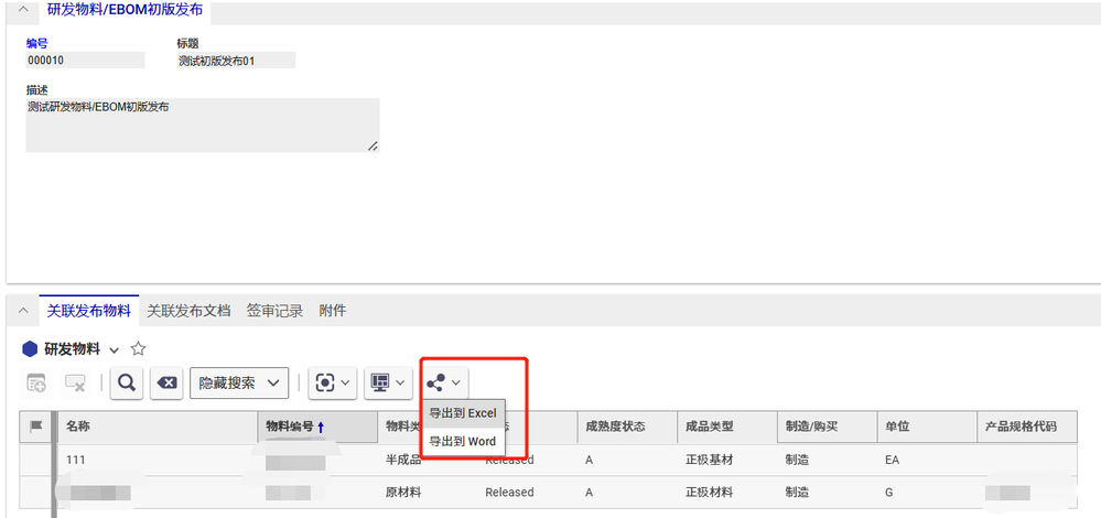

Hi Community,
We would like to control BOM download permissions. There is a function in Aras to export BOM to Excel or Word as showned in the below screenshot. Can we control this permission so that only permited person can use this menu? Do we need change program codes? If yes, which method should be used to realize this control?
Many thanks in advance.
Best regards,
Miranda
