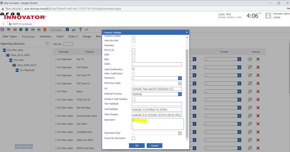

How to add a prefix to an property in SelfService Report
Example : I've an property on ITEM1 : Prop1 = "Val1"
I would like to display in selservice report the value for Prop1 = X_Val1
Can I use Expression or other solution to avoid calculate on dedicated property ?

    We can also use expressions to manipulate text. Let’s say that we have 'ShipCity' (e.g. Berlin), as well as 'ShipCountry' (e.g. Germany).
    Using the following expression:
    [ShipCity] + ', ' + [ShipCountry]
    • Breton's avatar
      Breton
      :-) , Thanks a lot.
      it is exactly what I wanted.
      It works fine
