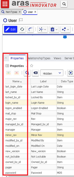

That didn't quite solve my problem, but it did get me working towards a solution which is partially successful. Now the issue is that I can get all property names, but not the labels... Newest working code below...
I guess part of the answer I was looking for was in the fact that the resultes are embedded into the XML nodes, not that I quite understand that structure yet....

End Class- asebastian6 years agoCommunity Manager
Could you post an example of the XML which is returned? I recommend testing the AML through nash, and then that way you can know what you'll have to parse using your code.
- et3ishak6 years agoIdeator II
Unfortunately due to security concerns, I cannot, but if you have a working example that simply iterates and displays the property names and values with a messagebox that would be tremendously helpful, I am looking to only access properties and labels of the default Aras Innovator User object....
