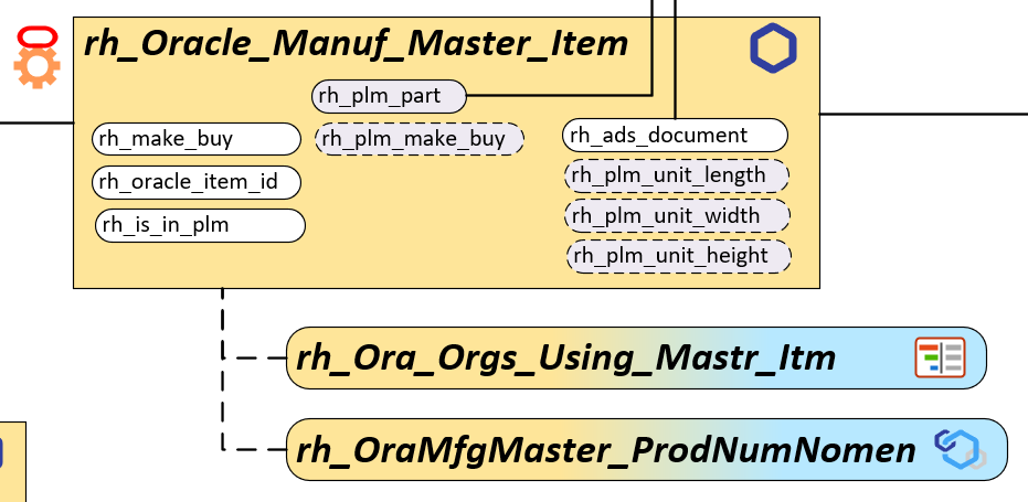

I am trying to "edit"/"update" the properties on a Non-Related Relationship; "rh_OraMfgMaster_ProdNumNomen".
