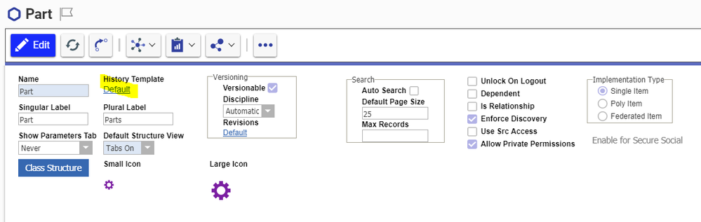

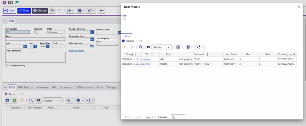

Hi Yogesh
I added a property in Part item type and enabled track history. Added the property to form. When I create part and update test property, history is tracked. History template is added in Item type : Default
