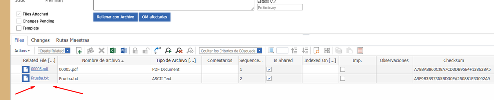

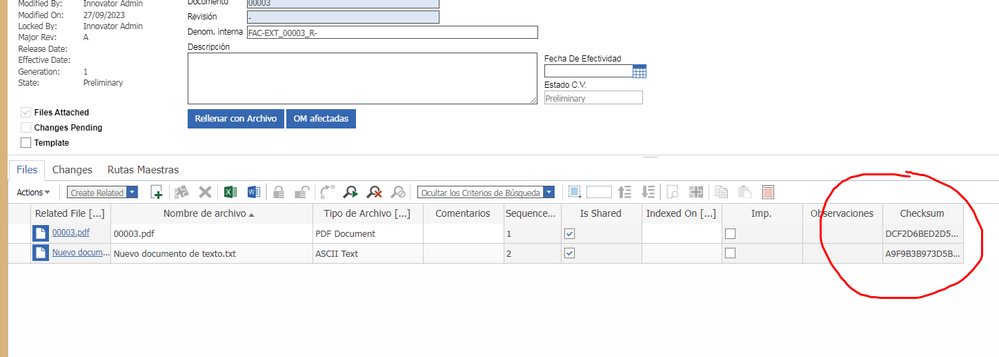

        Right now, in my version of ARAS, when you press the save button "save item", icon of a 3 1/2 floppy disk, from my time, hahaha. ARAS calculates the checksum and saves it. But as I mentioned, he does it in the file "xxhash-asm.min.js", in the line 2, but it is not tabulated and has 132,387 characters, why ARAS???.
        From what I have seen, it does this if a file is added and it is saved, if 2 files are added it does not calculate the checksum, I don't know why!

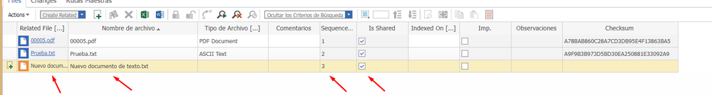

        We had thought that the verification would be done when the user clicks on saving the Item. Since you can add the file in two ways, adding using the button, or doing a drag and drop in the grid.
        Ideally, if it is through the add button it should not be a problem, since the dialog box appears, but if it is dragged, it should handle the event. ARAS already executes code, since it adds the name of the file.
