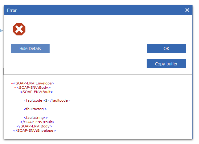

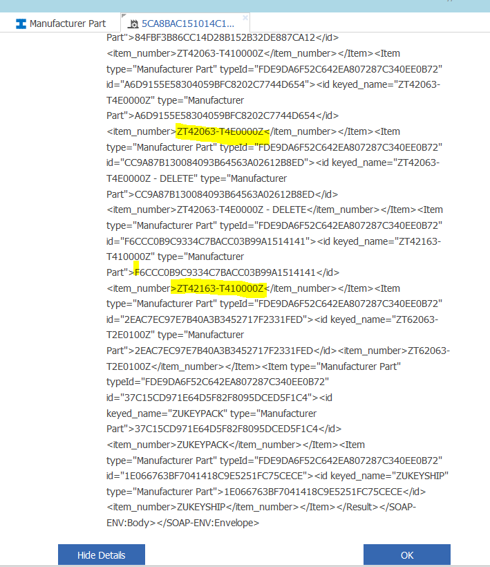

That´s really weird. Does your "getItemCount()" return the correct number items?
What result do you get, when you directly display the item in an error message?
E.g.
Item Man_Part_List = inn.newItem("Manufacturer Part", "get");
Man_Part_List.setAttribute("select","item_number");
Man_Part_List.setAttribute("where", "[Manufacturer_Part].IS_CURRENT= '1'");
Man_Part_List = Man_Part_List.apply();
return inn.newError(" " + Man_Part_List);I am little bit confused of your 'where' query. It´s not wrong and should work, I am just curious why you use it. Manufacturer Parts by default are not revised. What happens when you don´t use this filter or replace it with this version, that does the same:
Man_Part_List.setProperty("IS_CURRENT","1");
Is your query part of a bigger query? So for example you also search for Parts and Part AML at the same time?

Thanks angela for helping me on this. Here are my comments.
1) Does your "getItemCount()" return the correct number items? -- Yes
2) What result do you get, when you directly display the item in an error message? - Attached the screenshot
3) What happens when you don´t use this filter or replace it with this version, that does the same:Man_Part_List.setProperty("IS_CURRENT","1"); -- Tried it. But the results are same. It will still not give any name of the ManufacturerPart - Attached the screenshot. We have changed out Manufacturer parts to have revisions.
