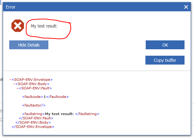

It is weird. I used the same code on my environment and for me it returns NULL.The only change is, am using newError instead of newResult but that should not make any difference.
return inn.newError("My test result: " + cur_man_part_name1);
