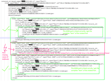

GetItemRepeatConfig removes child items that are used multiple times. How to fix?
Hi community, I use a classical "GetItemRepeatConfig" query to get a Part BOM over multiple levels.  id="xyz"; Item partItem = inn.newItem("Part","GetItemRepeatConfig"); partItem.setAttrib...

    I was also in a similar situation to expand the related items but couldn't able to make it using GetItemRepeatConfig when the item repeated in the BOM. I end up writing a SQL stored procedure to get the max level of a BOM and constructed an AML query to fetch the result.
    Would like to hear from ARAS if there is any better solution for this issue or status of the bug.
