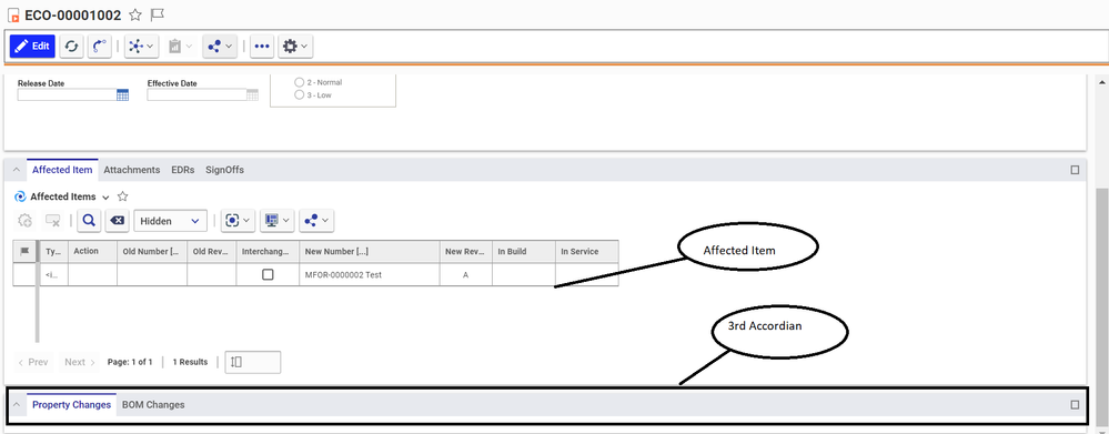

Hi All,
Is it Possible to get the Affected Item Preview in Third Accordian in ARAS. Consider I am having one Affected item and that affected item has three form tabs so When I select on Affected Items Relationship Grid the Whole Affected Item with all its Form tabs should get display in the new Accordian.

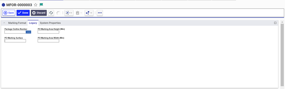

in above image I have Created third Accordian and in My second Accordian I have my one Affected item by selecting that affected item in Third accordian the Whole affected item Preview should get display as shown in second image where in I would able to edit that affected Item as I wanted to see the Redline  View of the same.
Thanks.
  • I like the use case. I know that Aras Innovator latest version allow to modify the tabs, also I have never done it personally. Do you know, if it is possible to display a third accordion at all? Is there are use case were this setup is already used?
