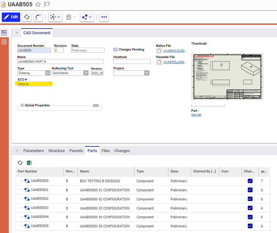

      Yes, as an example:
      I have a CAD Document with ECO field - our drafting team fills in a solidworks property in the CAD which is carried to Aras via the connector, in this example 300219
      I then have an OnAfterUpdate method that takes the number and proliferates it to all the Parts that are related to this drawing via Part CAD relationship:
      This part is working fine.

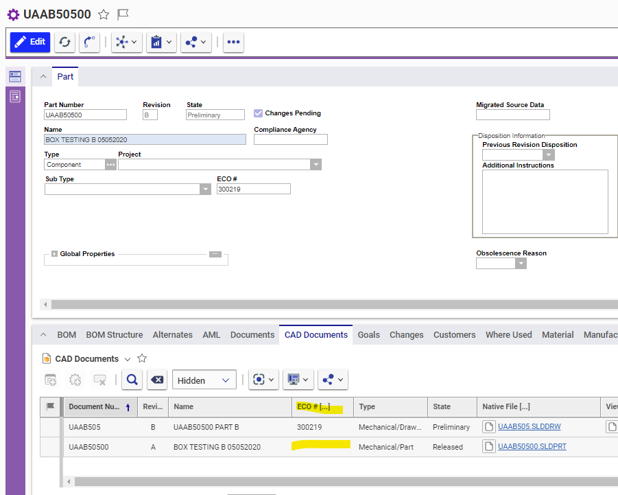

      The next step I need is for all of these parts, let's take UAAB50500, if there is a Document related to it via Part Document, I need that document ECO to update as well:

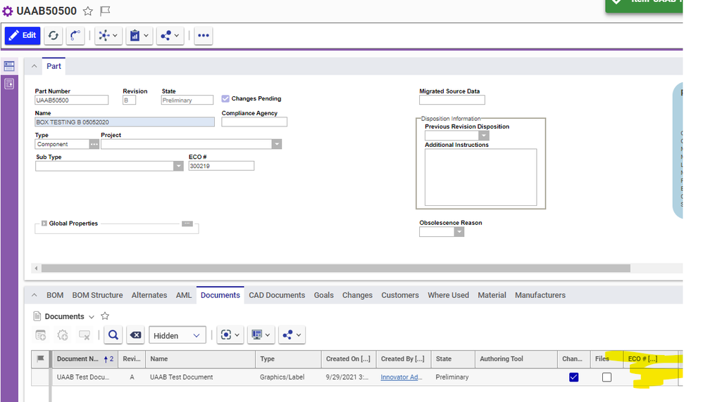

      Lastly, the model for this part needs to be updated to include the ECO number.
      Currently, the method looks like this, and works for the portion that updates the parts but that is where I am stuck. I want to get relationships from the parts for these so I can get a handle on their related items, but not sure if this is possible when making a query using an idlist.
