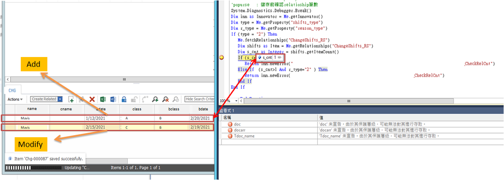

    • Mavis's avatar
      Mavis
      Hi Gopikrishnan,
        I tried fetchrelationship
        but tested that it only works in add mode(onbeforeadd)
        When modifying the mode((onbeforeupdate)), it only records the initial data
        And the relationship that I added in the modified mode he does not save
        Can you please tell me why this is happening and how I can fix it?
