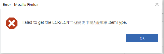

but click the form to see contention will show this Error Message:  Failed to get the ItemType.
Anyone could give me a hint about it?

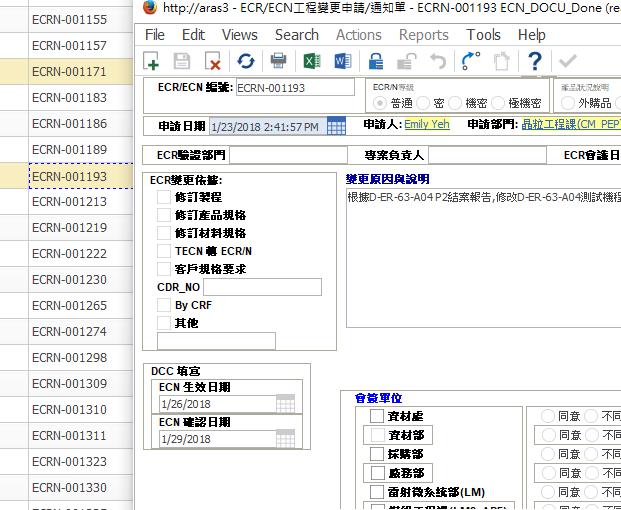

      Figure 1 and figure 2 all on beforeget event:
      Now I filter a condition ,it works and double click can see the form's detail.
      code:
      (figure 1)
      This is my question,I want to show two different conditions at the same time(ex: A = a or B = b),it works but  double click  form didn't respond and click  will get an error:
      (figure 2)
      code:
