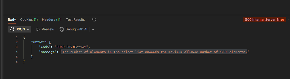

    I tried to delete a part in the interface and I got the message, before the search crashed. Tried it through REST and I think its the same message:
        "error": {
            "code": "SOAP-ENV:Server",
            "message": "The number of elements in the select list exceeds the maximum allowed number of 4096 elements."
    Guess I'll probably have to gut my xClassificationTree and try something else, if OP is correct, each xp field generates 3 selects, putting the max at 1365 or so...
