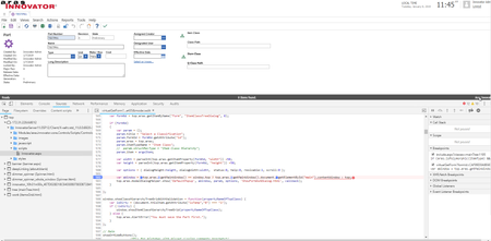

It looks like this error is being thrown in a custom form event you have on the Part ItemType. It looks like you're trying to get the main window in order to open a dialog for the user. There's a standard aras function that you can use to achieve this that should resolve the error you're seeing.
top.aras.getMostTopWindowWithAras();
Please try to use this function to set the value of the aWindow variable in your method. If you'd like more information on using custom dialogs within a javascript method, you can see this blog post.
