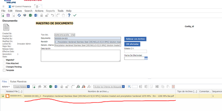

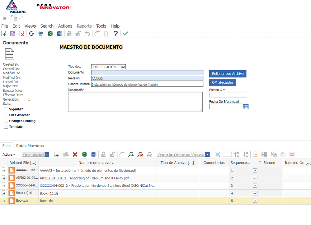

Look, curiosity!!, I'm giving you a series of screenshots of the debugger, in case you see something "strange", you who have an expert eye on ARAS, :)
ARAS has given the id, the full file name is in the variable, but when trying to upload it to the server, it fails. Enter an infinite loop.

There is nothing strange in your screenshots. As you have highlightend in the images, there is an error when sending a POST request. So probably the server disliked something.
When uploading the file, the server either doesn´t accept it at all, or will cut the name to a certain length.
Alaxala explained it very well. You have to check the full file path in the file Vault. While copy&pasting the file to the desktop will probably work, copy&paste to the File Vault structure might fail.
I have seen in your screenshots, that certain characters in the file name are escaped. But not all of them. This could also be a source of trouble. But I assume in your case, it´s really just the file length.
