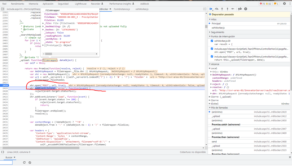

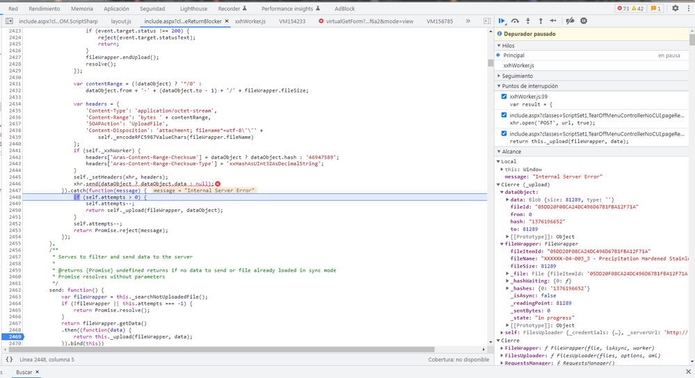

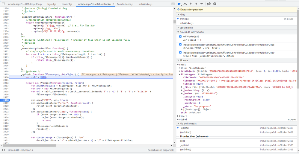

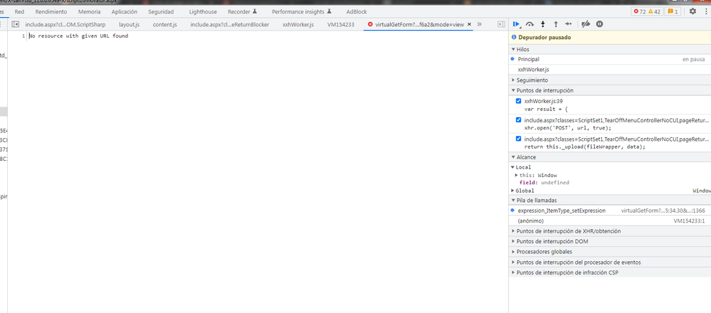

      Look, curiosity!!, I'm giving you a series of screenshots of the debugger, in case you see something "strange", you who have an expert eye on ARAS, :)
      ARAS has given the id, the full file name is in the variable, but when trying to upload it to the server, it fails. Enter an infinite loop.
      I tried to copy that same file to the server with the explorer and without problem.
