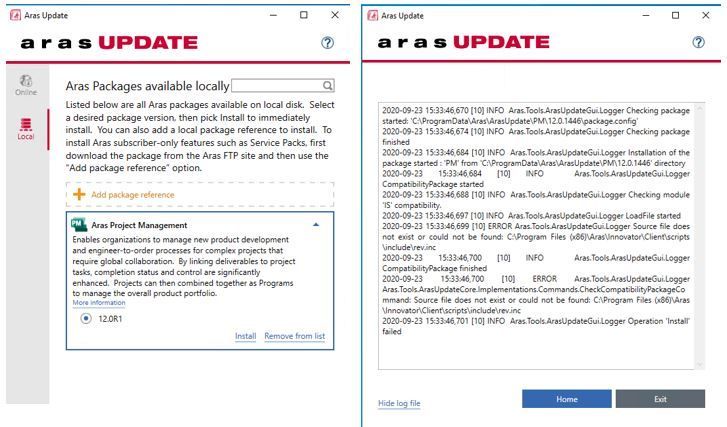

Recently, I installed ARAS Innovator 12 SP9.
Afterwards, I tried to install 'Aras Project Management' in it using 'aras UPDATE' tool.
However, I got the error message saying that  source file does not exist or could not be found 'C:\Program Files (x86)\Aras\Innovator\Client\scripts\include\rev.inc'.
But, when I check the location of 'rev.inc' in the server, it doesn't exist in  'C:\Program Files (x86)\Aras\Innovator\Client\scripts\include\rev.inc' as the error message says.
I find that it exists ' 'C:\Program Files (x86)\Aras\Innovator\Innovator\Client\scripts\include\rev.inc''.
In this case, would you please help what I can do to fix it?

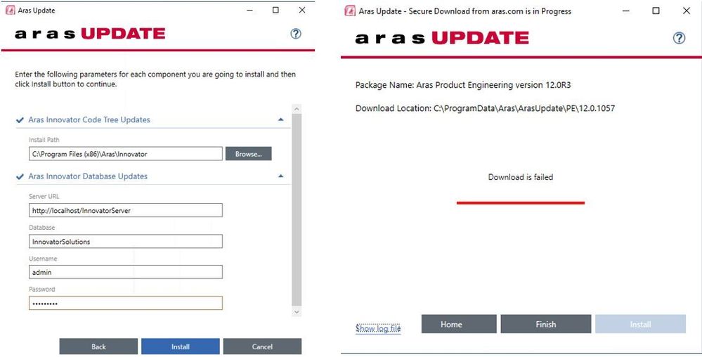

Secondly, when I tried to download 'ARAS Product Engineering' in 'aras UPDATE' tool, I got the error message 'Download failed'.
I tried many times. But, I got the same error message.
Would you please help how to solve this issue?

    Hi Joseph,
    Could you try pointing the installer at the innovator/innovator folder? I believe that's what the installer is expecting when looking or the rev.inc file.
