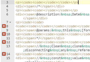

ERROR: client-side validation method: (intermediate value).format is not a function
I can't figure this out. I simply want a ... ceiling on a calendar input value.What is happening to this? I can take the same passed value and do the same operation in Chrome dev tools and it works perfectly as expected.
What is Innovator doing here? It logs the inputTime, as a number, and I can take the same value and pass it to the same formatting function outside of this onChange listener function.

  • Hi Neil,
    I guess the support of .format was dropped in Innovator 12. As far as I know .format is not a native JavaScript function in Data.prototype.
    I took a quick look and checked how Aras deals with dates, e.g. in the Method ES_ReindexAll. In 11SP15 .format still was used, but the code line does not seem to work at all. In 12SP3 a new version showed up that does not use .format. A clear hint that something went wrong in the past.
    You could use var mydate = new Date().toLocaleDateString("en-US")); or DateTimeFormat.
