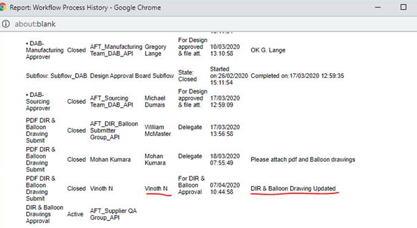

The ask is to edit or change the comment in a signoff report of a closed workflow process.
the task is already in closed state with some comments as shown below
But now they wanted to rewrite the comment differently as per some requirement.
I couldn't find any direct ways in PLM to modify the signoff comment. Thought to do this from Backend. But i couldn't identify the relevant data table where the workflow process sign off history is stored.
First of all Is this a valid request? if so how to modify the comment in signoff history?
Please throw some light!
Thanks.

    Hello Sbala,
    Comments are present in Activity Assignment. You need to updated Activity Assignment for that activity.
    You need to search from Workflow_Proccess->Workflow_Process_Activity->Activity->Activity_Assignment
    And you need to update comments property for that Activity_Assignment Item related to activity.
