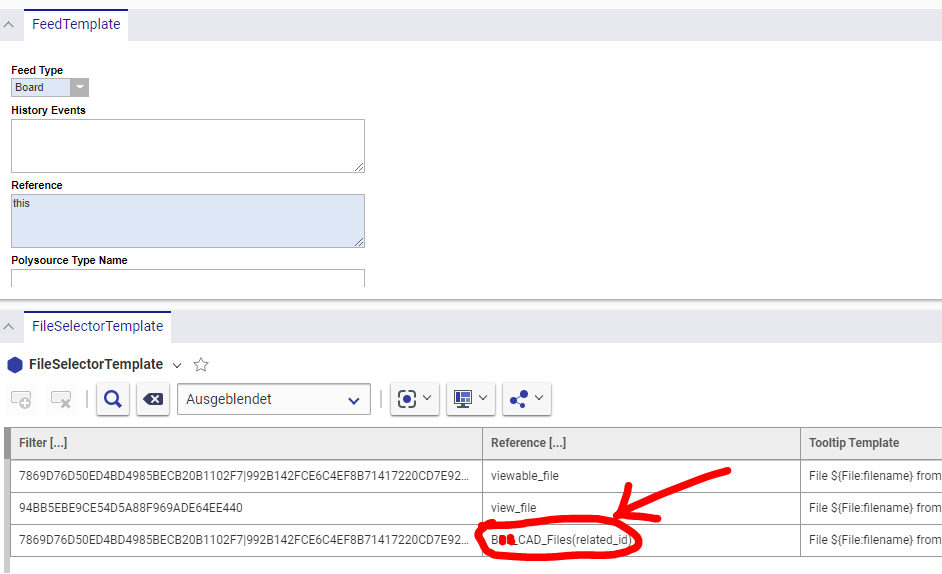

    I guess your haven´t configured the SSVC settings. Check out the Secure Social tab in your ItemType. You specify there which files are linked to the sidebar. Just take a look at CAD or Part itemtype for reference.

      Thank you very much for taking time out of your day to respond. No, I do not see the dynamic views icon in the sidebar.  I have taken a look at Secure Social > DiscussionTemplate> FeedTemplate>FileSelectorTemplate for the CAD ItemType.  I see that it has a Reference as

        I used a custom CAD relationship by myself and remember I had to add my custom ItemType there so I can access the files in the sidebar.
