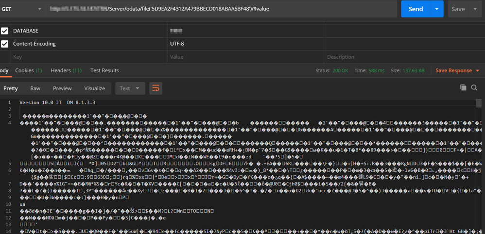

      • Hafedh_Elfaleh's avatar
        Hafedh_Elfaleh
        Even via postman I got the same problem with content-encoding
