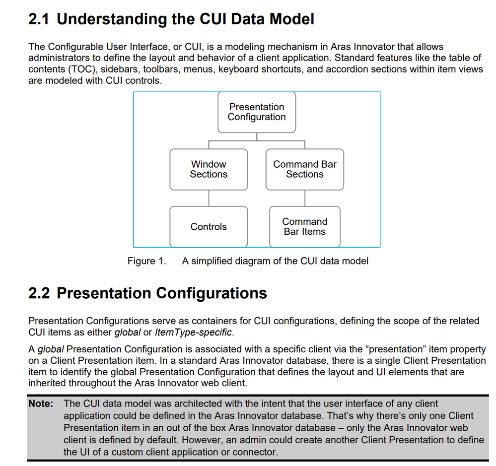

  • High Level Overview is available in :
    Aras Innovator XX - Configurable User Interface Administrator Guide.pdf
