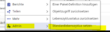

    You can reset the used lifecycle map by an admin action. But this will reset the complete lifecycle.
    (Translation is something like "set standard lifecycle". Try it in a test database first).
    If you already use different states for you items, you then have to re-promote the items after using the action. If you are open minded for a more dangerous but efficient approach: You can also use SQL to update the "state" and "current_state" property that are used for the LifeCycle. It maybe even eliminates the step to reset the lifecycle with the admin button, but I never tested this one. You basically need to know the id´s and names of the target states of your new lifecycles and directly modify them in the database. But try definitely in a test database first.
