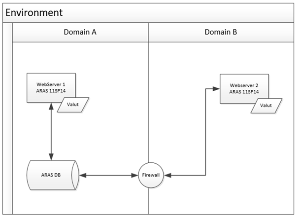

  • You can have have multi-site in the following fashion
    1. Distributed application servers
    2. Disturbed vault with vault replication on demand or realtime
    To achieve number one

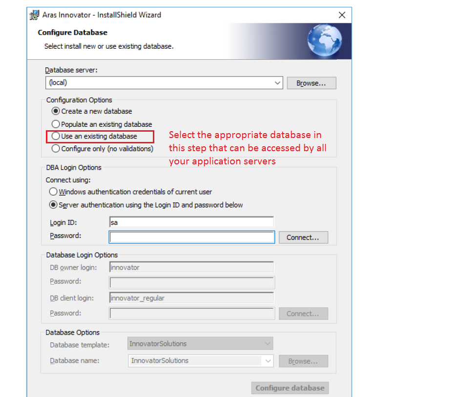

    1. run aras installer msi file
    2. continue until the database configuration step
    3. ensure the centralized database is within the network
    4. in the step where it asks for dataselect using existing database option
    5. the search for your database
    6. proceed with installation of the Aras Application server
    If using windows server you Have NLB(network load balancer) as a feature create a balancing cluster read more documentation of using NLB
    for 2
    follow documentation of vault replication in the document section of your aras sp iso zip file
  • if you have more questions you can get in touch with me i will be able to help you out with the desired configuration

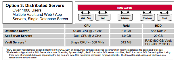

      Just for reference, this is a simple diagram from the client, showing what they want.
