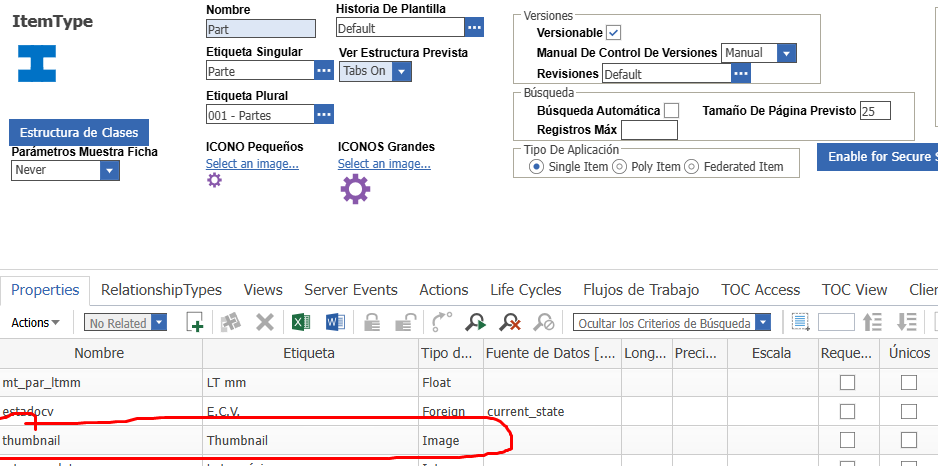

I'm trying to make a report with SSRS, what I want is to show an image saved in an attribute of an itemtype.
Well, I can't do it, I've tried several methods that I've seen on the internet, chatgpt, but nothing. Can you give me any clues?.

We still have the Aras Innovator Version 11.0 SP9 Build: 6549
