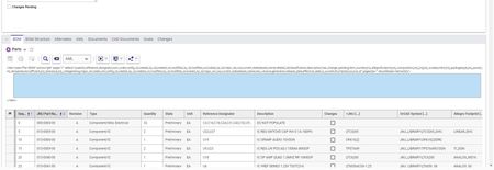

For posterity:
I have realized that I can visually "refine" and re-arrange the columns and then hit "Save Layout" in the Part BOM tab, and this applies to the same view on other Parts. I am not sure whether this applies across different Aras users or not.
For printing the Part BOM with AML, I discovered the Multilevel BOM Report, and realized I can edit the Query PE_multilevelReport to add the extra Part properties I wanted to show and edit the Report Multilevel BOM Report to actually view those extra Part properties.
